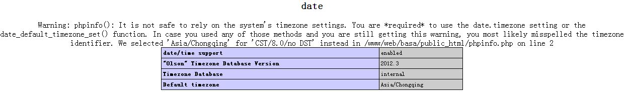

查看phpinfo的时候出现如下提示
  1. Warning: phpinfo(): It is not safe to rely on the system's timezone settings. You are *required* to use the date.timezone setting or the date_default_timezone_set() function. In case you used any of those methods and you are still getting this warning, you most likely misspelled the timezone identifier. We selected 'Asia/Chongqing' for 'CST/8.0/no DST' instead in /www/web/basa/public_html/phpinfo.php on line 2

谢谢版主,修改后确实好了
WDLINUX
应该是需要在php.ini中指定个默认时区
