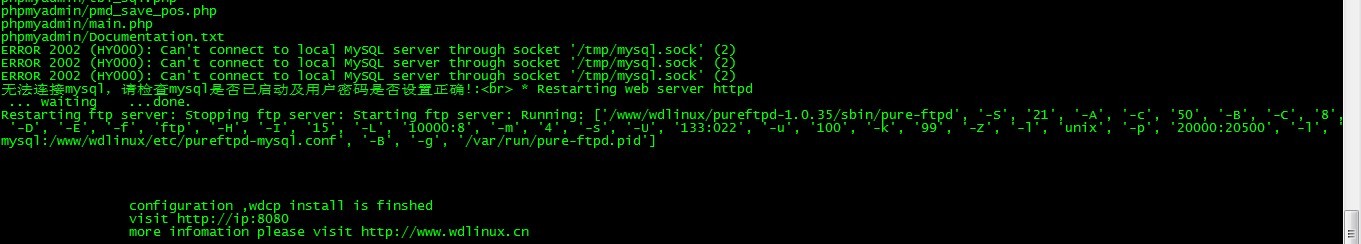

[求助] ubuntu 11.04 x86 安装lnamp时报错
错误显示为
  1. phpmyadmin/server_binlog.php
  2. phpmyadmin/pdf_schema.php
  3. phpmyadmin/print.css
  4. phpmyadmin/tbl_sql.php
  5. phpmyadmin/pmd_save_pos.php
  6. phpmyadmin/main.php
  7. phpmyadmin/Documentation.txt
  8. ERROR 2002 (HY000): Can't connect to local MySQL server through socket '/tmp/mysql.sock' (2)
  9. ERROR 2002 (HY000): Can't connect to local MySQL server through socket '/tmp/mysql.sock' (2)
  10. ERROR 2002 (HY000): Can't connect to local MySQL server through socket '/tmp/mysql.sock' (2)
  11. 无法连接mysql,请检查mysql是否已启动及用户密码是否设置正确!:<br> * Restarting web server httpd
  12. ... waiting    ...done.
  13. Restarting ftp server: Stopping ftp server: Starting ftp server: Running: ['/www/wdlinux/pureftpd-1.0.35/sbin/pure-ftpd', '-S', '21', '-A', '-c', '50', '-B', '-C', '8', '-D', '-E', '-f', 'ftp', '-H', '-I', '15', '-L', '10000:8', '-m', '4', '-s', '-U', '133:022', '-u', '100', '-k', '99', '-Z', '-l', 'unix', '-p', '20000:20500', '-l', 'mysql:/www/wdlinux/etc/pureftpd-mysql.conf', '-B', '-g', '/var/run/pure-ftpd.pid']
  14.                 configuration ,wdcp install is finshed
  15.                 visit http://ip:8080
  16.                 more infomation please visit http://www.wdlinux.cn
复制代码
mysql没启动,方便发IP,密码来看下

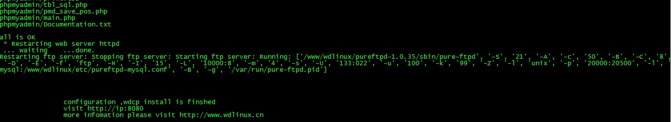

重装系统为12.04_x86后 Mysql 不报错了但 prueftp 不能启动,安装完LNAMP后报错如下
  1. phpmyadmin/main.php
  2. phpmyadmin/Documentation.txt
  3. all is OK
  4. * Restarting web server httpd
  5. ... waiting    ...done.
  6. Restarting ftp server: Stopping ftp server: Starting ftp server: Running: ['/www/wdlinux/pureftpd-1.0.35/sbin/pure-ftpd', '-S', '21', '-A', '-c', '50', '-B', '-C', '8', '-D', '-E', '-f', 'ftp', '-H', '-I', '15', '-L', '10000:8', '-m', '4', '-s', '-U', '133:022', '-u', '100', '-k', '99', '-Z', '-l', 'unix', '-p', '20000:20500', '-l', 'mysql:/www/wdlinux/etc/pureftpd-mysql.conf', '-B', '-g', '/var/run/pure-ftpd.pid']
  7.                 configuration ,wdcp install is finshed
  8.                 visit http://ip:8080
  9.                 more infomation please visit http://www.wdlinux.cn
复制代码
根据提示信息pureftp是启动了的,用netstat 看看所有服务对应的端口是否监听,如果都监听成功则为正常,另外mysql如果再出现无法启动请重新下载lanmp一键包,修复了一处mysql帐号添加失败导致服务无法正常启动的问题。
